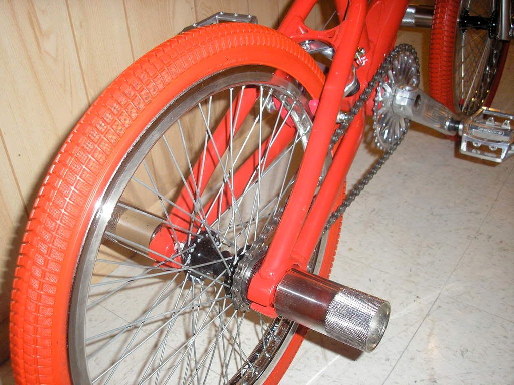

1998 GT Show
http://bmxmuseum.com/image/p5180106.jpg http://bmxmuseum.com/image/p5180107.jpg http://bmxmuseum.com/image/p5180108.jpg http://bmxmuseum.com/image/p5180110.jpg
1998 GT Show
1998 GT Show.  Flatland tuned, custom painted hotrod red with red and chrome components.

Fully restored, and modernized. The total weight of this bike with all the components installed is 27 pounds. The restoration was finished, and i took these pictures on 02/25/09. The serial number on my bike is 10970152 S
COMPONENTS
GT aluminum Show Frame pac-man rear dropouts and u-brake mounts.
GT show minimal offset 1 1/8fork with pac-man dropouts and u-brake mounts.
gt handlebars, Dia-Compe 990 front and back brake.
Dia Tech brake levers, sst brake cables and gyro, London mod for back brake lower gyro cables(The London Mod is a part that allows you to run 2 brake cables from the gyro, to the bake brake rather then a typical gyro cable. The gt show requires a special gyro cable that is hard to find. A regular one will not work because the top tope is welded to the bottom tube, and the traditional lower gyro cable is not long enough. The London mod is a great work around and makes the brakes more responsive.)
Gt monster knurled pegs, primo v monster red tires. GT Hub and rim, brickhouse minimal offset stem, GT seat and a random seat-post (27mm).
odyssey 28t sprocket, GT Aluminum FSA 175mm cranks, Redline pedals with 9/16 thread, Dia Tech d-cup headset.
ADDITIONAL COMMENTS
This was a fun restoration project that is now complete. I cant wait until summer so i can ride this. If you have any questions about restoring a GT show PM me or email me at jameslinesceo@gmail.com and i would be glad to help. Thanks for looking!!
